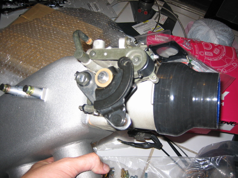

Ok I should be installing the HKS inlet tomorrow.
Since you guys helped me get over my retarded notion of only thinking about peak cylinder pressure as making power, I wanted to discuss further how a new intake manifold will effect the tune.
I'm swapping my Magnus + 63mm TB for HKS Inlet + q45 TB.
Now let us assume the HKS will make more torque everywhere. This means that for the same boost pressure, more air is filling the cylinders. Now if more air, this means, if I keep ignition advance the same, peak cylinder pressure will rise. Therefore, it seems reasonable that I will need to take a degree or two of ignition out of the map on boost probably?
But the increase of air will allow for a greater amount of work to be done against the piston over the entire power stroke which will offset the loss of the degree or so of advance?
Am I on the right track? Practically I will simply make sure I have sufficient margin from the car det'ing but I want to understand the theory before I go for it.
