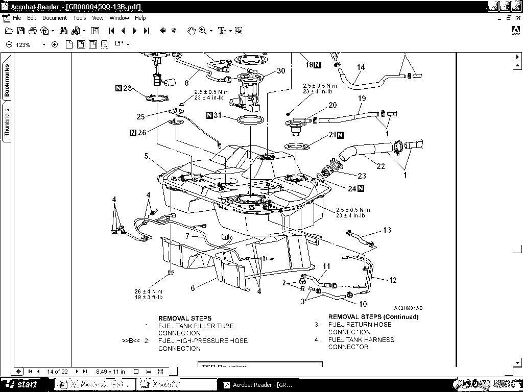

This car has a saddleback fuel tank that is almost like having two tanks side by side. I used to have a Corvette with this same arrangement and funny things could happen if the car wasn't level at the pump. Here is a pic of the tank.
