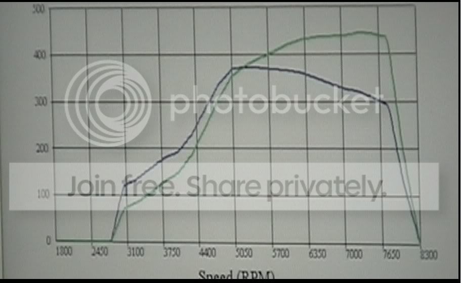

phenix and xiaoni - Are you guys on stock displacement?
What about the 3082 (3065) that ETS sells? Is that equivalent to buschur's 3065? From the dynos i've seen, it looks like the PT61BB or the 3065 is what i'm looking for.

The 3082R or 3065 as it's called by some is a 35R compressor wheel and 30R turbine wheel. It is available either from Precision or from Garrett, but the wheel package remains the same in both cases.

Stock Bottom, Stock head, Stock Ecu, Stock MAF.
