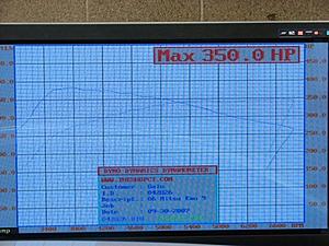

We do have 93 octane here in indy. I don't have too much info about the dyno, other than it was done a couple different times. All I have is this graph from the seller, I will talk to him to see if he has any other info ect he can share.
how is the quality of ss autochromes stuff? I know for other cars, it's not fantastic. Will it eventually break? And should I go with a ported exhaust manifold or tubular ones? I thought I read that the ported stocker didnt net much gains, but provided reliability.
*I know the graph doesnt match the numbers I stated, but like I said it was retuned a couple times, and in the for sale ad, the numbers where 350whp, and 320wtq, So I assume thats after this graph?

Hey Tommy,
Dyno number varies from day to day weather and dyno to dyno and different correction factor. That dyno graph that you have there was from my original tune with 680cc injectors. I had to get a retune because we took out the 680cc. Whatever the reason was, I kept getting the system to lean CEL. Even driving normally. The tuner thought it was the injector or something so we took it off and retuned the car.
I was pretty upset about the torque lose after the retune but it did get rid of the tune. Im not familiar enough with tuning so I left it all to him to handle.

DynoDynamics with no correction factor, which is 1.00. Wow, 1.2? You cannot tell people it's 350hp when the CF is 1.2. No wonder it's so high. That means it's only making 292whp/267wtq. That is a HUGE difference...
Why would it have such a high correction in Indy? I'm in Colorado at 6000', and our CFs are usually 1.26-1.32 due to how high we are. Indy isn't nearly that high, so the dyno operator must be inflating the numbers manually. Even when the CF is 1.26-1.32, we cut it in half for turbo cars to get a sea level comparison. For instance, my 325/342 would be 367/386 up here for trying to guess sea level numbers, but that's still just a guess. If I used 1.2 like you, it would be 390whp/410wtq! Lord have mercy!
