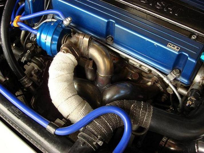

Here's what I did with a green ,hks manifold,and tial
tell what you think of the welding?
looks like hks factory.
where does the wg dump pipe route back too? got a pic of that weld as well?
