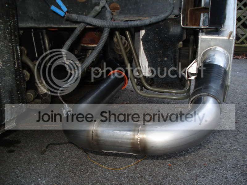

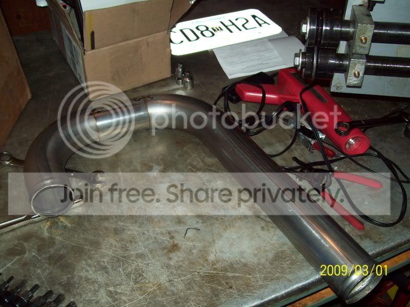

LICP pipe is fabbed up and beadrolled and ready for tig welding:
And that's how she sits now...
