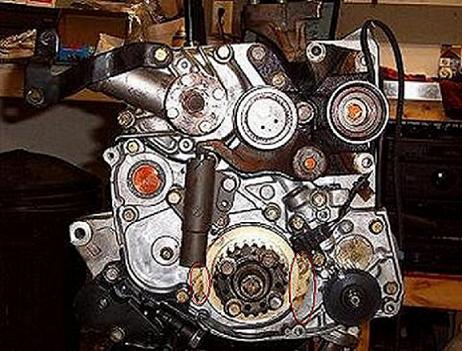

does ne one know what these parts are??? and if they have them that i could steal off a blown or spare block??

What parts do you need. Are you talking about the water pump, timing belt pulleys, tensioner, crank position sensor, trigger wheel, oil pump.....dude is alot. a lill specific?

Those red circles are very faint and if I didn't have a keen eye I wouldn't even notice it since you did t not specify it in your post.

Thats your Crank Positioning Sensor "trigger wheel". get it from your dealer cause is cheap..

sorry for not being specific... i have the trigger wheel.. but what i need are the peices that stick on the trigger wheel.... any ideas what those are??? like rc had said they are circled in red. Thanks for the help guys!

That IS the trigger wheel. post a pick of what you're calling a trigger wheel. There is only 3 things bolted to the front of the crank. the timing belt drive gear, behind it is the cps trigger wheel and then the rear balance shaft drive gear.

i think what your are seenig is the tooths of the trigger wheel scuffed by the timing belt.
