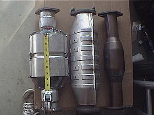

What other high flow cats did you test?
It was a custom made 3" with a high flow Catco core, (see pic).
I would really like to see it compared to a stock cat setup with an aftermarket 2.5" or similar size downpipe and a 3" catback. I believe David Buschur said the two most restrictive part of the stock exhaust are the downpipe and the catback.
All I can tell you is that a test pipe was one of the very first mods I tested on my car. With everything else being stock I measured a good 10-15 WHP just from the test pipe. That's actually not that much compared to other turbo cars where removing just the cat in some cases has been good for 20-30WHP. That just shows how good the stock exhaust system system really is.
Yep, it just goes to show you that the 30 WHP + gains for the aftermarket turboback exhausts are pretty realisitc.
