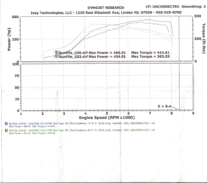

I just had this turbo installed at Ivey's along with Qtp 02 dump and ported exhaust manifold. I love this turbo top end is awesome with very little lag compared to stock IX turbo. We were having some problems with boost creep on 93 oct. It hits 20psi then slowly creeps to 25psi in the higher rpms that is why the torque spike is down some. Ivey's suggestion was to go with a Tial 38mm External Wastegate to eliminate the boost creep. Since the 02 dump is already in place it shouldnt be to hard to weld up. The 780cc injectors were maxed out on 100oct he suggests going to 1000cc and it should get over 480whp.
On 100oct and 30+psi (my gauge only goes to 30) the turbo really wakes up and it pulls very hard to 8k redline. No boost creep on 100oct. Overall this is a fantastic turbo for a bolt on car (especially top end) at 25psi with 93 oct but it really shines at higher boost with higher oct. Ivey is the man great tuner and top notch service as well!!!
435whp 367wtq 93oct 25psi
466whp 415wtq 100oct 30+psi

If i had E85 around me i would do that unfortunately there are no stations near me. I'm on the Stock Cams. The Idle was too aggressive for me on the Cossies. The car runs much smoother on stock cams atleast for now. I'm interested in putting a milder cam probably the Kelfords or HKS in the future. The diameter on the pipe is larger on the QTP thats why i was surprised it had some boost creep. Sean said the compressor is pushing to much air for the flapper in the internal wastegate, his suggestion was go to external and/or contact FP.

Boost creep happens when a wategate cannot bleed off enough exhaust gas flow BEFORE it reaches the turbine wheel. The 10.5 single-flapper housing's turbine bypass port(s) as cast are restrictive. There is a lot of porting that needs to be done at the turn in radii from the turbine inlet area. Also, the fact that there is an axial divider wall reduces flow volume.
O2 housings are post bypass port and thus, are located aft of the restrictive wategate bypass port in the turbine housing. Bolting on a free flowing O2 housing won't always solve the problem of the restrictive bypass port in the turbine housing. Don't get me wrong I am not against the O2 dump setups on the market. Actually, I want one.
I am merely a proponent of thoroughly porting the turbine housing to improve bypass flow as a means of diverting exhaust flow at the turbine inlet before it reaches the main scroll area and the turbine blade tips. The turn in radii are too tight and the port itself is too restrictive. Improving bypass flow by porting the turbine housing can help reduce boost creep independently of whether or not the O2 housing is free flowing.
