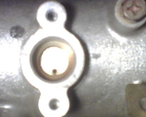

When I pull out the stock sensor, there is a dark gold insert-like looking surface with a very small hole in it. I know it doesn't look dark gold in the picture, but it is.

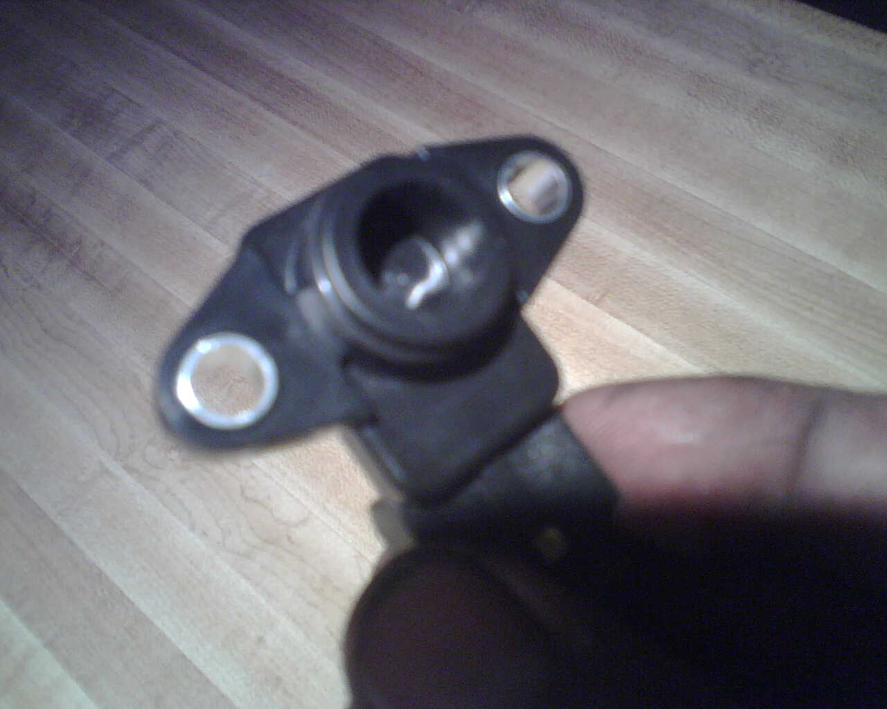

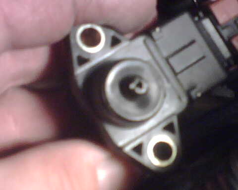

The stock sensor has a small nipple on it .
The new JDM sensor is a simple hollow cap
Do I use the old nipple on the new sensor?
If NOT, do I pull out the "gold insert" (if that is even possible)?

1. the gold (insert?) with the hole,
3. the Stock sensor (USDM
2. the new sensor.

We took a chance this morning and just put the JDM sensor in without any other modification.
After making the prescribed changes to the ROM, everything seem to be working ok. I still need to fine tune the Altitude offset, but we were pretty close.
The nipple on the old sensor does not appear to be swap-able, we watched for odd behavior from the MAP readings, but they seemed OK, so we left the gold insert as it was.
I have the same gold insert. '06 IX GSR
Didn't get in the way of the JDM MAP installation, but then again I think I'm having boot leak issues now. They may have already been there before installing the JDM MAP. I'll find out this weekend when I do a boost leak test whether its the MAP sensor that's leaking.
