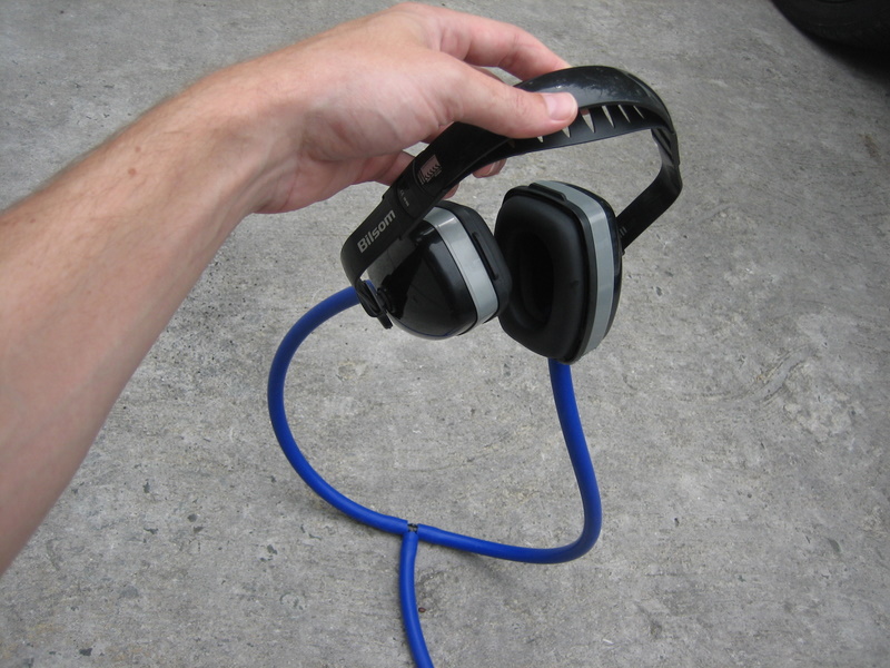

Why are you suggesting I would tune a car without a proper way to monitor an engine? I happen to use some homeade det cans.. half of which can be seen here:
http://www.clubctrl.com/headphones.jpg
But again, the subject is not how to listen for det.

94, I'm not sure if you have ever used the type of det cans I made for myself, but let me explain to you what det sounds like with them. In the headphones all you hear is the valvetrain humming along, nothing else. And when you encounter det, it appears as a distinct and singular "tick". Now I guess your saying that singular tick is deadly to a motor

Seriously 94, it is a well known fact that knock occurs well before you can hear it audibly with your naked ear yes. But with det cans you essentially have a stethoscope on the friggen motor. How you think anything significant is happening before you hear it with det cans tells me one thing... you've never used proper det cans.
Reread my post. I said they are good tuning tool. But used in conjuction with AEM and 5volt knock sensors I found there is an area of knock about .50-.75volt wide that is not audible through detonation cans. Does that help?
also it is mathematically impossible for knock to improove power. knock is an uncontrolled instant explosion that occurs when the piston is at or very near TDC when it is in no position to do possitive work on turning the crank. Knock also shatters the thermal barrier that keeps 2000+ degree combustion temps from reaching the 900 degree melting point of your pistons.
very simply knock cans are great if you know how much to retard the timing when you start to here knock.
The point i was trying to make is the first signs of knock connot be destinguished from normal combustion sounds. Not with detoantion cans and certainly not with naked ear.
