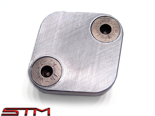

or http://www.streettunedmotorsports.co...te_dsm_evo.htm
-Em

Originally Posted by EmeryatSTM
VERY nice looking piece!

i've already used the patch to disable the egr now i'm just waiting to send my intake manifold and throttle body to buschur and i'll be getting STM's egr block off plate

tapping the head or manifold close to the head sounds like a little too much...an egr block off plate does the job just fine and has always
