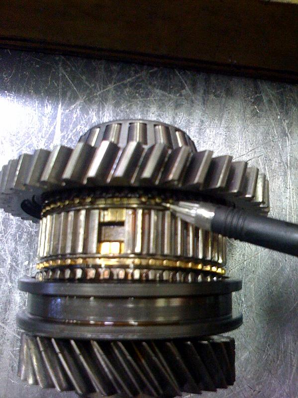

huh?? pretty sure there is a synchro in reverse! I build transmissions for a living, and have done tons of evo trannys, and YES there is a synchro for reverse, I've replaced them

i'll post up a picture of the gear set to show all of you that there is a synchro for reverse. There's a synchro for every gear in this transmission

heres the gear set as a hole.... (5speed)

and heres me pointing a pen at the synchro for reverse

this is the gear set from a 5 speed, but the six is just about the same...
