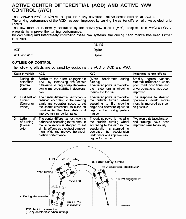

This is what it does :

As you know in the 7 & 8 GSR/RS2, the systems are linked / part of the same system. Same ecu, same hydraulic pump, same sensors. ACD yields better steering response and traction in the corners... the AYC component helps with corning limits... one should always consider the ct9a active driveline as a complete system. To me the system works to seamlessly extend the handling limits and response over my all-viscous 6rs. I would have to drive the US evo in anger to be absolutely sure of the % subjective improvement.

Unlike a viscous coupled center differential, the ACD is mechanically geared to a 50:50 torque spilt. This is only seen when the diff is in 100% lock mode (typically in straight line driving on tarmac). What changes is the opening/slippage between the clutch plates in the diff itself, varing from a fully open diff (no power to rear wheels) to fully locked.
In Tarmac mode ... which has the highest locking force and least slip of the three, the diff opens up (i.e. slips) instantly on turning the wheel allowing for increased steering response.
In Gravel mode (recommended for wet tarmac) ... which has a lower ultimate locking force value, the diff takes 2-3 secs to unlock. Thus sending more power to the 4 wheels on gravel, but still enabling good steering feedback.
In Snow mode ... the locking force is lowest and takes around 5 secs to release.
Get this : the system behaves differently on different surfaces. CCC magazine once said it was as if the electronics know that you are trying to trick it! For example, putting it into Gravel on Dry Tarmac causes the center diff to remain locked for longer and thus sending more power to the REAR wheels... thus causing the oversteer. On wet pavement, putting the car into Gravel mode (as is recommended) quiets the car down and glues it to the road!
The coolest thing about ACD, is that it unlocks the center diff immediately on application of the handbrake, just like a WRC diff.... no need to dip the clutch for handbrake turns!
