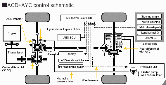

Its a whole different ball game....
That hydraulic pump alone is a little more than a £1000 if you can find it....

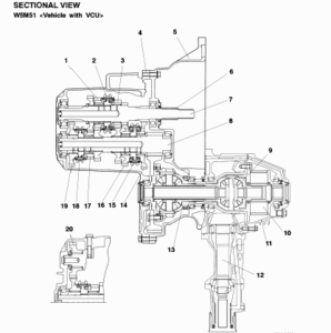

In case anyone wondered what the mechanicals look like....
US Tranny & VCU :

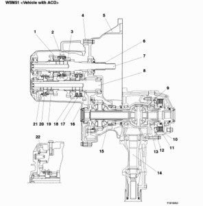

JDM / UK tranny and ACD :
1. 4th gear
2. 3rd - 4th synchronizer
3. 3rd gear
4. Transmission case
5. Clutch housing
6. Clutch release bearing retainer
7. Input shaft
8. Output shaft
9. Front differential
10. Clutch housing
11. Transfer cover
12. Piston
13. Transfer hydraulic case
14. Hypoid pinion
15. Center differential
16. 1st gear
17. 1st - 2nd synchronizer
18. 2nd gear
19. 5th gear
20. 5th - reverse synchronizer
21. Reverse gear
22. Reverse idler gear
