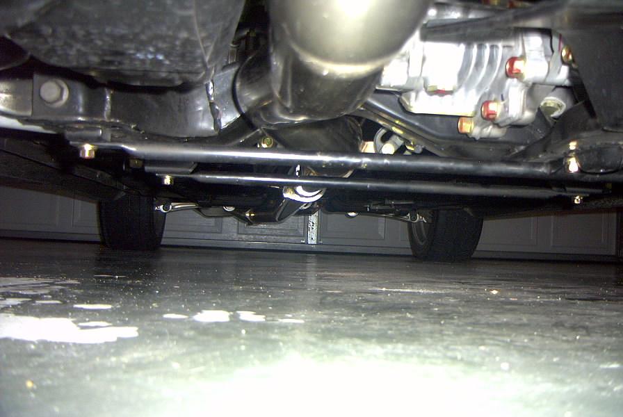

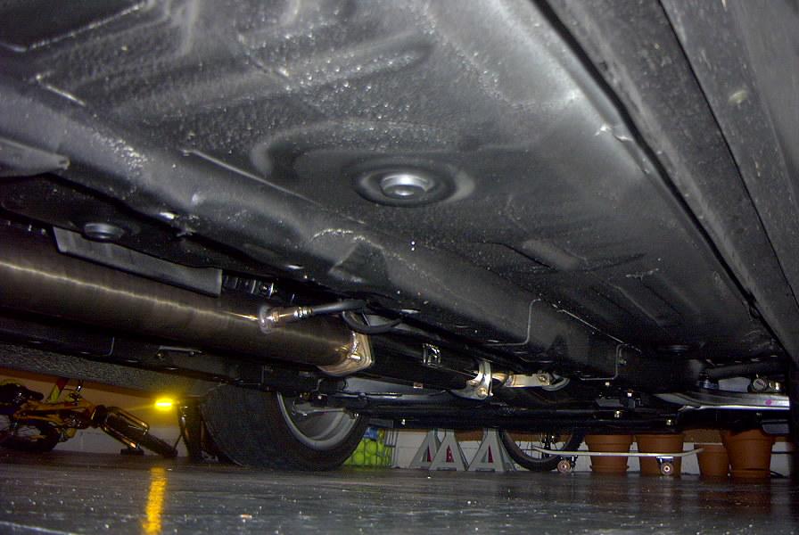

Look at the B&B set up. 3'' no fittment problems. Downpipe clears the factory bars. I have a cat delet pipe, but it would work with the factory cat or what ever you want. Here is a pic of the side underneath of the car.

The B&B system that is pictured CANNNOT be a full 3" diameter pipe. I gaurantee it. There is 3.25 inches of room between that lower support and the cross memeber above it. From what I see in the picture there is a 1/2" of room between the pipe and underbrace. This means if it is 3" then it is slammed into the crossmember above it. Measure the tubing, it is not a 3" downpipe. In order to fit the full 3" downpipe through there we include 5 stainless steel .400 thick spacers in our kit. This drops the stock underbrace down .400 of an inch. This gives the clearance needed for a TRUE 3" downpipe.
