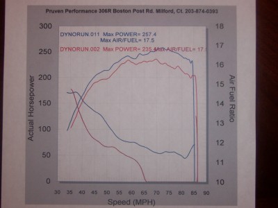

Stock Evo Dyno Flash dyno sheets - big variance between stock evos!
We saw a BIG variance between stock evos today on the dyno.
Each stock EVO needed a vastly diffenet tune to get to the same power point. We feel more and more that through the mail tunes are not adviseable on Evos. There is far too much variation between evos - same dyno - same day - big difference between the cars. One of them just needed to have big time fuel pulled out to get it in line - the one that made 257 to the wheels
Last night we did one that made 274 to the wheels
It seems the stock evos range from 210 - 240 to the wheels - thats a big range
The onlt tune that we would offer through the mail on evos would be a very very mild slight tune - about 1/2 our regular on the dyno tune
This one picked up and AMAZING 46 whp with just the flash !

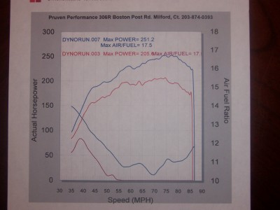

here is another
This guy's evo was much stronger - but needed a lOT of fuel corrections - me made more power than the others though

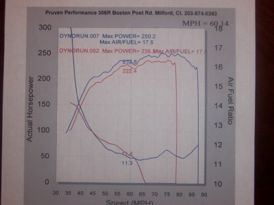

Here is the last one - 93 octane map a bit less power - the owner wanted a very safe tune - a bit less ign timing

Why do the dyno sheets have NO A/F?
What gear are the pulls done in?
What octane fuel?
Thanks.

Looks like all have AFRs to me did you mean TQ??

Those are some ugly AF.
Is AF hard to control on the EVO?
What octane maps were the other tuned at, 94? I actually feel like Exxon 93 seems a tad better than the Sunoco 94. I know a lot of other people in other states feel the same.

We dont tune the cars to have flat a/f curves - we run much richer than most with a bit more timing and we put in even more fuel at points were knock activity occurs to prevent the ecu from pulling out timing
At least WE release out a/f curves and dyno sheets and publish them here. Some of the other reflash tuners don't like to share that info with you guys. While we stay super rich to avoid any problems - they run it close to 12/1 all the way accross the power band - I rather put in more fuel run more timing and make even more power with a colder and safer tune.
We look to have a flat power curve - or as flat as we can get it. You dont feel a/f's when you drive the car - you feel the power. Thats why all my clients are usually remarking how smooth the car feels when they go on their test drives. Also - i personally drive each and every car myself to make sure its running 110% before it leaves the shop.
