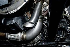

^Picture of the 02 housing with a straight through 3" design. This design w/ vband eliminated the 2.5" donut flange!
^ Here is the pic with the 3" 02 housing and the custom downpipe that eliminates the 2.5" donut flange.
I don't have back to back data because I installed this with my Red, however I don't see very many Reds making 540hp on 30psi like I do, if any at all... I think it has a lot to do with this 02 housing. I make more than my friend Yahu and he has a Black and all the other mods that I do, except for an external dump 02.
Mikey

^ can u post more pics of ur o2 housing. interested to see how it is on the flange side.
Thanks

Thanks for the pic!
