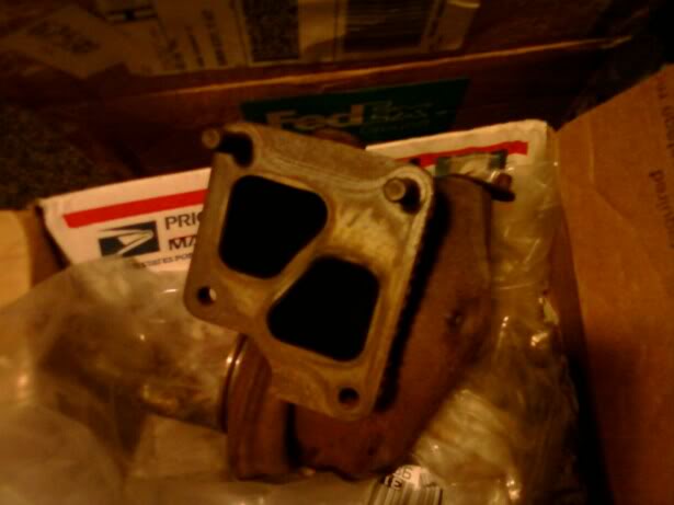

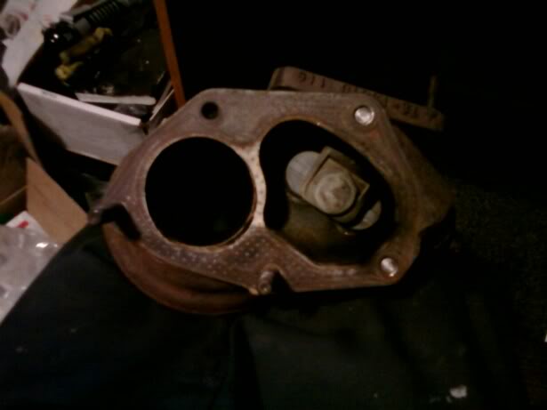

I ordered a 10.5 hotside from a member on here, and correct me if I am wrong, but this is NOT a 10.5 hotside, right??

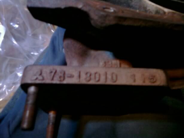

Does anyone know the #'s cast into the dual flapper 10.5 hotside? The one's on the hotside in question are....
78-13010 115

My guess is that it is indeed a 10.5 dual -flapper.

Anyway the number on my old 10.5 hotside it 49378-13050 105

Yours is a 10.5 single-flapper right Silk? So that number would be different than the 10.5 single-flapper number, correct? To answer the question, I still say that the housing in the pic is a 10.5 dual-flapper.

There are three factory dual-flapper turbine housings for the 16G: The 10.5, the 9.8, and the 9.0 housings. I have both the 9.0, and the 9.8 in my garage. So, I went out to check the numbers and neither the 9.0, or the 9.8 have that serial number. So, it is a safe bet that the OP`s housing is a 10.5 dual-flapper.
