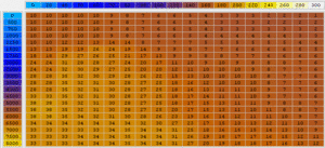

and a quick look at my timing map for the old cams

Picking up something that isn't really knock and continues to pull timing which does nothing for what it is actually picking up?? Idk. I am trying to think of anything.
