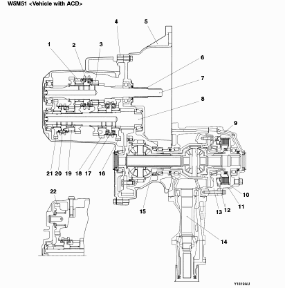

BTW, Jemm, are you sure the centre diff is located in the transfer case? I'm not as familiar with the later Evos, but on the earlier ones the centre diff is in the gearbox itself. The transfer just converts the drive from transcerse to longitudinal.

Hi Wreckleford, yeah its outside of the gearbox proper now. When
rotated the engine post Evo 3, it was changed.
1. 4th gear
2. 3rd - 4th synchronizer
3. 3rd gear
4. Transmission case
5. Clutch housing
6. Clutch release bearing retainer
7. Input shaft
8. Output shaft
9. Front differential
10. ACD Clutch housing
11. Transfer cover
12. Piston
13. Transfer hydraulic case
14. Hypoid pinion
15. Center differential
16. 1st gear
17. 1st - 2nd synchronizer
18. 2nd gear
19. 5th gear
20. 5th - reverse synchronizer
21. Reverse gear
22. Reverse idler gear
EDIT : #5 was mislabelled. corrected.
1. 4th gear
3. 3rd gear
5. ACD Clutch housing
7. Input shaft
8. Output shaft
10. Clutch housing
11. Transfer cover
12. Piston
14. Hypoid pinion
16. 1st gear
18. 2nd gear
19. 5th gear
21. Reverse gear
1. 4th gear
3. 3rd gear
7. Input shaft
8. Output shaft
10. Clutch housing
11. Transfer cover
12. Piston
14. Hypoid pinion
16. 1st gear
18. 2nd gear
19. 5th gear
21. Reverse gear
