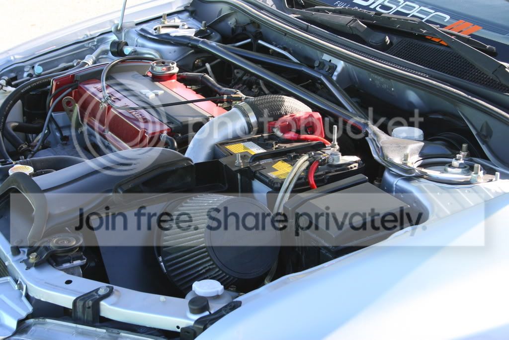

I passed the forbidden Cali SMOG test with Cosworth 272 cams...
2006 Evo IX
Tuning Technologies dyno tune
TD-05 16G Turbocharger
Cosworth 272 M2 camshafts
ETS 3" front mount intercooler
ETS 2.5" lower IC pipe
AEM short-ram intake
Forge MBC
Megan 3" TBE (consist of DP, TP, and catback exhaust) w/ resonated test pipe -----------> replaced with crusty OEM catalytic converter...!
Walbro 255 fuel pump
Precision 780 fuel injectors
These are the Smog Check numbers my car produced...
TEST RPM CO2% O2% HC (ppm) CO%
IDLE 1020 14.30 0.10 MAX 100; AVE 17; MEAS 6 MAX 1.00; AVE 0.00; MEAS 0.00
2500RPM 2595 14.50 0.20 MAX 130; AVE 12; MEAS 11 MAX 1.00; AVE 0.10; MEAS 0.00
And this is what my engine bay looked like during the time of the inspection...
2006 Evo IX
Forge MBC

So did you tune the car to pass smog or use the tune you already had? I planned to swap in cat and OEM injectors. Would be nice to pass with just a cat.
I passed the cali ref test with the cossie 272's, gm 3 port, tune, catback, apexi intake, 780 injectors, rear o2 disabled...little bolt on stuff. I had to throw the stock downpipe and cat on to pass the visual though, cat can't be out of factory location to pass legally and high flow ones fail as well. welded a 3" flange onto the rear of the cat to fit my exhaust but even that isn't legal
ref inspections are a little more in depth though. I run the stock springs with the cams with no issues 7200 shift point

My car appears 100% stock so I'm not too worried about being sent to a ref. Though Fresno PD likes to send people "just in case". I hardly drive the car anyway.
Injectors and exhaust swap, and I'm back to stock.
I just wanna pass smog. Sounds like I can with either of these cams.
