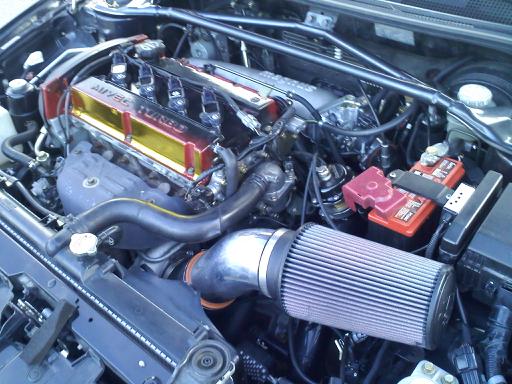

Mikey or Aaron,
Can you guys post a picture of the intake y'all used? Also what UICP is being used?
I will be converting to SD and ECU-controlled boost. I need to get these two parts nailed down.
-Acree
Old Jul 15, 2010 | 11:07 AM
  #723
churchja's Avatar
Posts: 302
From: Redondo Beach, CA
Originally Posted by Acree
Mikey or Aaron,
-Acree
Acree... Look Here (This is the intake Mikey's using):
ER's 4" intake
https://www.evolutionm.net/forums/8429048-post628.html
Attachment 339285
Old Jul 16, 2010 | 10:35 AM
  #724
BLKCarbonEVO's Avatar
Joined: Nov 2008
Posts: 3,463
From: VaBeach, VA
Acree, It is a ER 4" as pictured above. I am using the ETS Magnus specific short route UICP. I absolutely love it.
You will really like going to SD, driveability is awesome and you will gain a few hp!
Mikey
