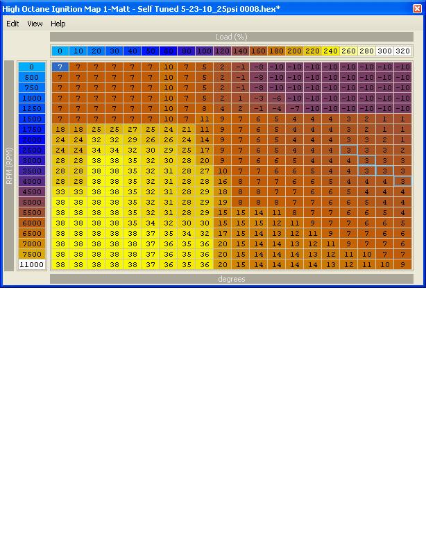

interesting, can you post your timing maps for high and low octane

i posted the high....both high and low are same....also since i have the tephra mod i looked at the alternate timin maps..and they are all normal as well...idk where my ecu is pulling these numbers from.
