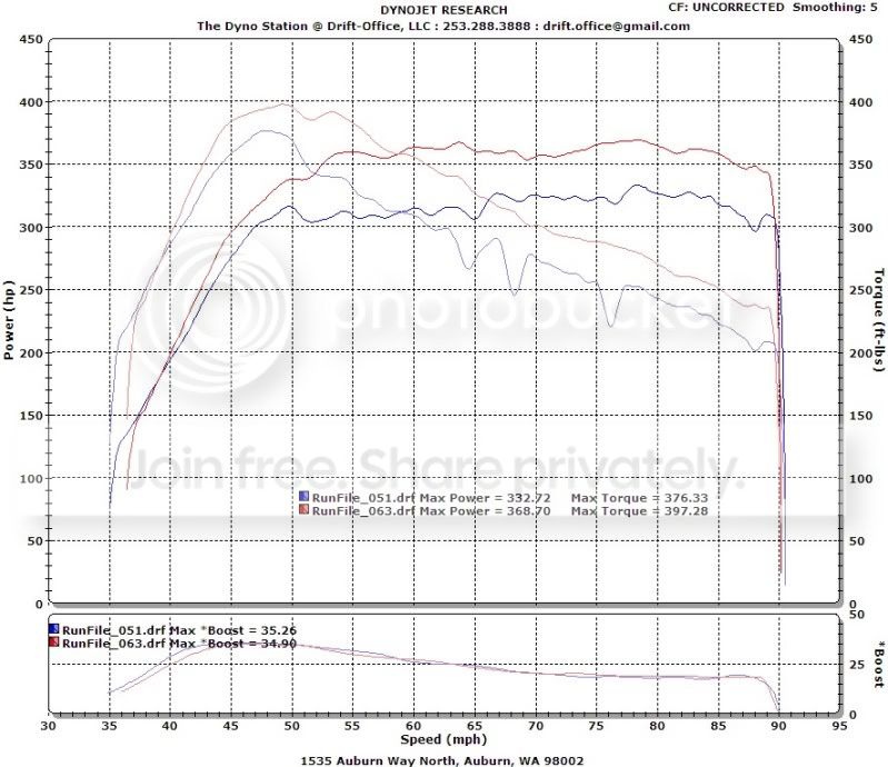

I'm sure others made a lot more, but I remember making 416whp with a BBK on stock cams on 93/4 octane. S2's and speed density made another 40 though. Since you have a 9 get S2's and don't look back. A good tuner will get them to idle close to stock, not lumpy at all. Good luck dude!
