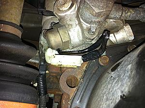

Anyway, heres what I found! I crawled under the car and I found it! Looks though it can't be pulled without draining the oil. The connection seemed tight, but it's dirty. I guess I'll replace it next oil change.

Hey BTW...What is this connection for? It was all taped up with electrical tape. Seems solid.

Yes on changing it when you do your next oil change...The connector just slides off the sensor - from memory I believe it is like a female connector. Regarding the wire, just make sure the wire is not exposed and touching the block or any metal as that will ground the sensor and trigger the light.
