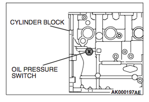

*whew* I thought I was going crazy.
d
EDIT: This figure is for the Evo 8 only.

You're the man! Thank You!

wow. I cannot find this piece on the car. The picture shows it being towards drivers side right? I removed the upper intercooler pipe, but I couldn't find this.

Deff back there. get a light and look for it. It will have a single wire attached to it. kind of circle shaped.

peer down between #3-4 runners on your intake manifold. there is a little goldish sensor with a one wire clip connector. that is the culprit. 27mm deep socket is required, you can get the replacement part at Napa.

reach your left hand down behind the IM, put the 27mm deep on the unit, put the ratchet on, crack it, take it out by hand. new one comes with red locktite on it so it wont leak, done in 5 mins, without jacking up the car.
just make sure its cool and you are good to go. part is less than $15
hope it helps!!! and cij911 its all good buddy, im just certain in this case cause i did it month ago myself for exactly the same issue. cheers
