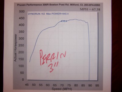

100% agreed with shiv's observations with stock coils and stand alones - noticed that Pruven had MSD ign and coils with its haltech equiped evo
The power band on a 400 whp evo whould look like this one tuned with just the dyno flash
