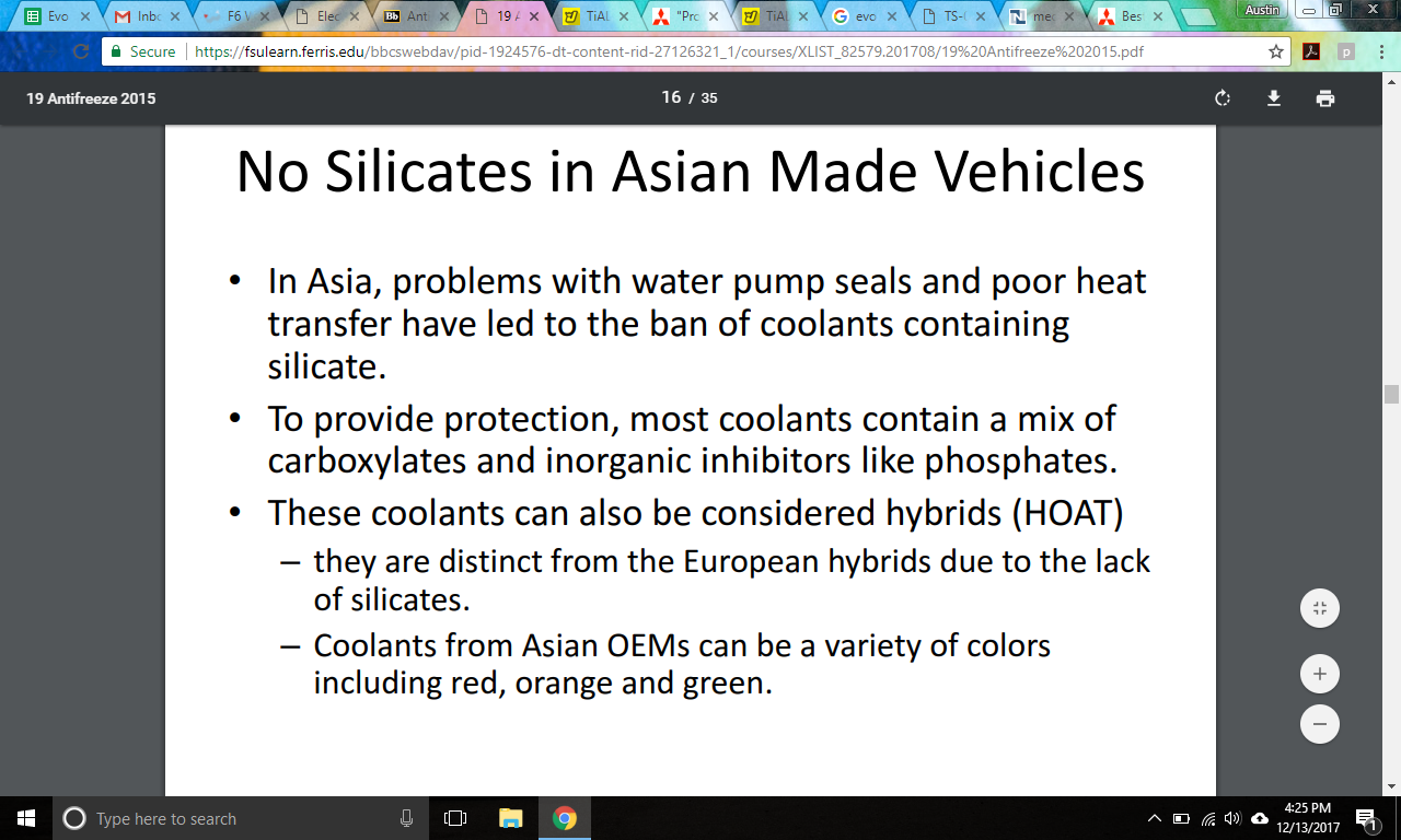

We talk about antifreeze in one of my classes and briefly touch on some of the chemical properties.
As for track uses, water and water wetter is without question the way to go. Not only does it cool better but you'll make a lot of people very unhappy campers if you leak glycol based coolant on track.
For an evo, avoid coolant with silicates in it. Here's some good rules of thumb (there are other asian coolant colors as well too, I know Subaru uses blue coolant, Zerex asian formula is pink, pretty much don't judge a coolant by its color):

yup - ZEREX™ Asian Vehicle has been designed to meet the requirements of Asian manufacturers, which specify a silicate free HOAT formula with a phosphate additive to protect their cooling systems from rust and corrosion

Pretty much all modern day coolants will provide proper metal protection, some older stuff used to cause scale formation in aluminum engine and if it got bad enough could cause the engine to overheat because the heat transfer was so poor.
Nowadays proper coolant means coolant that won't damage any seals or synthetic components in the cooling system. The biggest instance of such a failure is probably GM's Dexcool and it's incompatibility with nylon 6/6 which is used in a lot of seals and plastic components in older GM engines.
