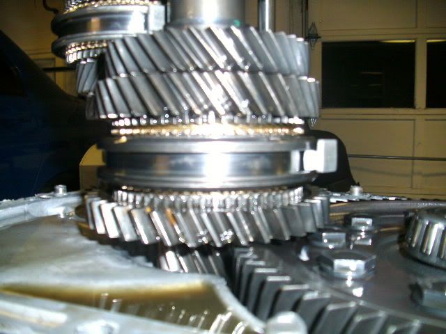

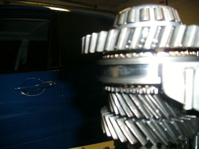

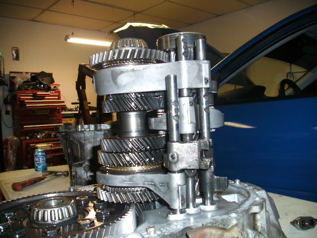

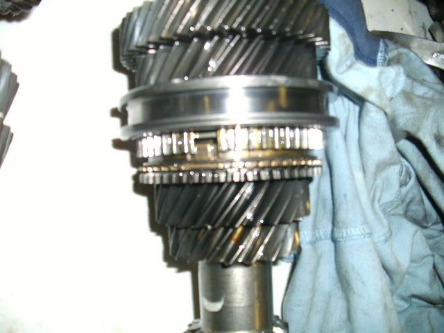

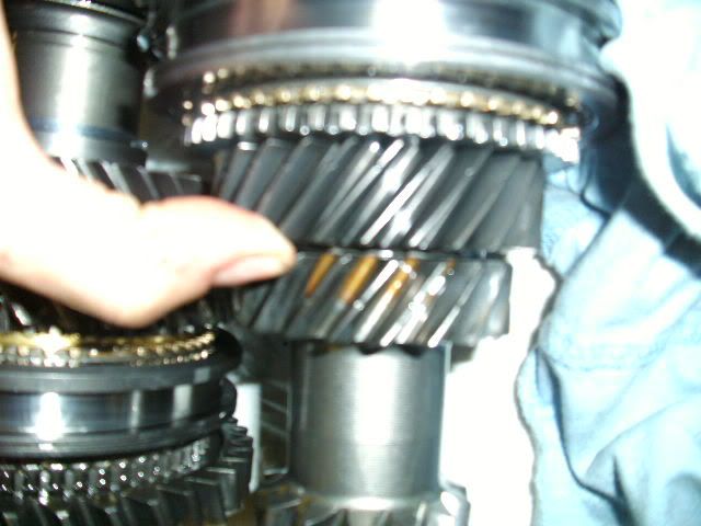

Car is an 03 and looks like I did put a slider hub on wrong if you go by the groove line one the other 2 hubs. Is there a different 5th gear? I didn't know there was more than one 5th gear, are they different thickness? I talked to the guy that owned it before me and he said Mitsu was in the tranny back in 04 or 05 cause it had a slight grind in 5th and they replaced the synchros under warranty. Also said there was a TSB for the 5th gear grind and some slightly redesigned parts. I have yet to research what was replaced but about to now.
I took some pics and there is a ton of play on the input shaft which is crazy cause I just changed the input shaft and went from number 6 half washers to number 9.....
Will be stripping the shaft and checking the specs to find what is wore to cause the play.

Pics of the tranny to see what I found

You cant use a evo 9 input with a 03 evo 5th gear.. 03 5th gear has shorter splines that is your problem.. You will need to replace it with a newer 5th p/n MN 107624
