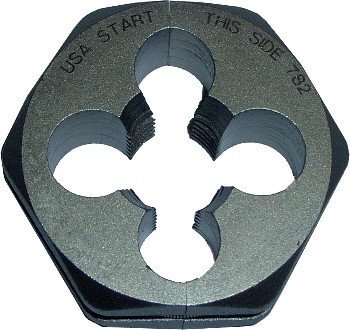

As for the bolt... you can look in the junk yard in similar Mitsubishi's and you may get lucky (Lancers more then likely, but also maybe a Galant or 3G Eclipse), you would be surprised by how much of that kind of stuff is interchangeable. That or you can try to repair the current bolt. Clean up the rust and grime, buy a Die Thread Repair tool and fix'er up.
a random Thread Repair Tool...
