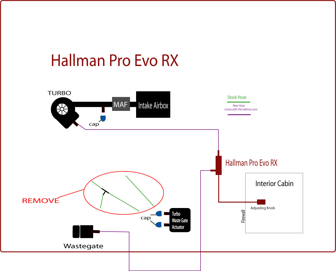

Can you post a picture or explain exactly how you have your MBC hooked up. Have you tried switching the hoses on your MBC. Not trying to insult your intelligence but that would explain everything and be a simple mistake.
My only caveat to that is normally when that happens, you create alot of boost.
Anyway, pics, diagram or explanation would help.

Okay i dont have picture right now, but i set it up exactly like this diagram. I know for sure that i set the MBC up correctly. Im pretty sure that the WGA was messed with by previous owner, so im going to adjust it this weekend.
