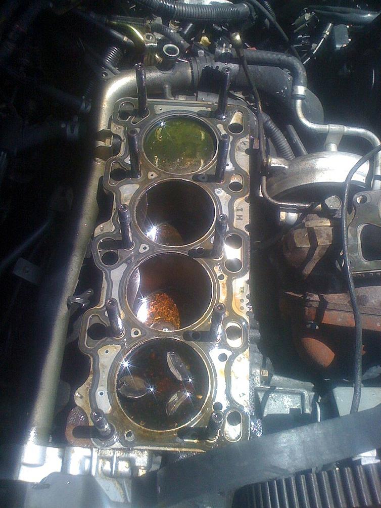

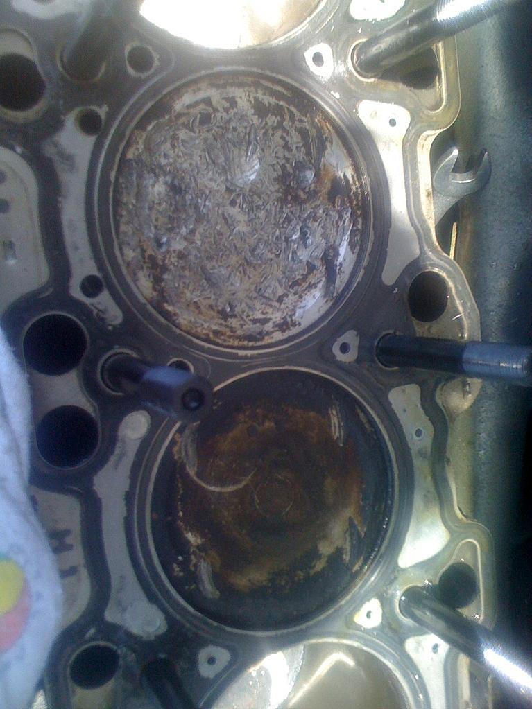

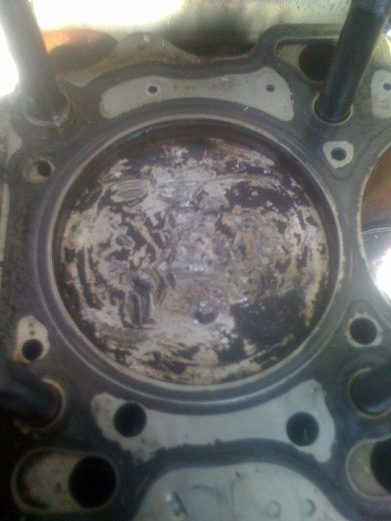

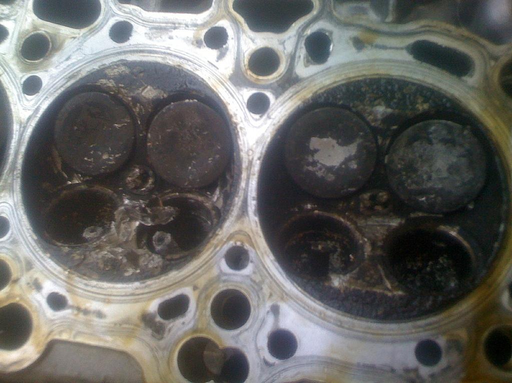

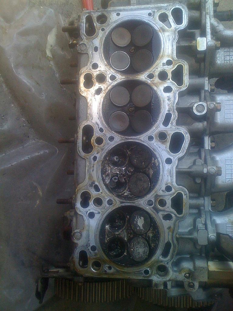

Updates Pics...

Wow. That's painful to look at. Who did your tuning?
Sean @ fftec in hayward,ca

That valve and piston looks crap. Thats cause belt broke huh... Sorry to see that

I would pull the destroyed piston and check the crank journals.
If they are ok, then you have options other than replacing the entire block.
Definitely check into sending the head to Buschur and get a Stage 3 head (forced upgrade).
Then if bottom end is ok, no metal in the oil or oil pan, maybe look into doing an upgraded piston and rod drop in build.
