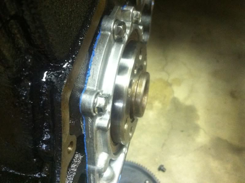

Im installing my Exedy twin disc onto my crank and it doesnt fit right. The crank is sticking to far out for the clutch to seat right. This is a 2.4 motor with the 100mm crank. Has anyone had this problem?

that center piece needs to come out of the crank.

ok it does look like it comes out. Do you have any idea for a good way to remove it?

its pretty tight in there, but it comes out. you can try renting a pilot bearing removal tool from autozone (free) to get it out.

You can also pack the inside full of grease and press it out hydraulically.

Yeah I got it out with a impact hammer. Wasn't fun
