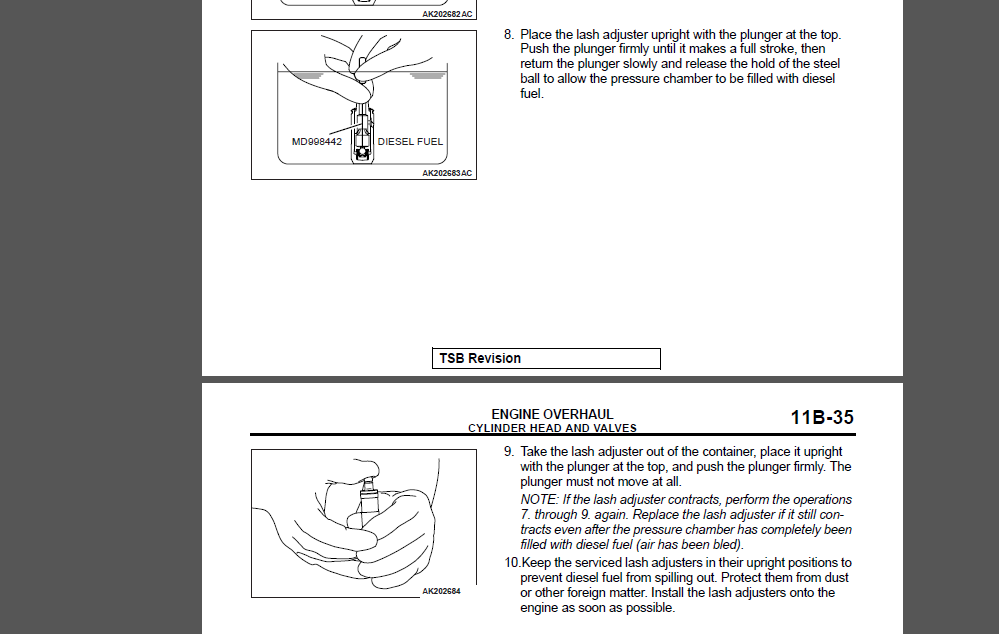

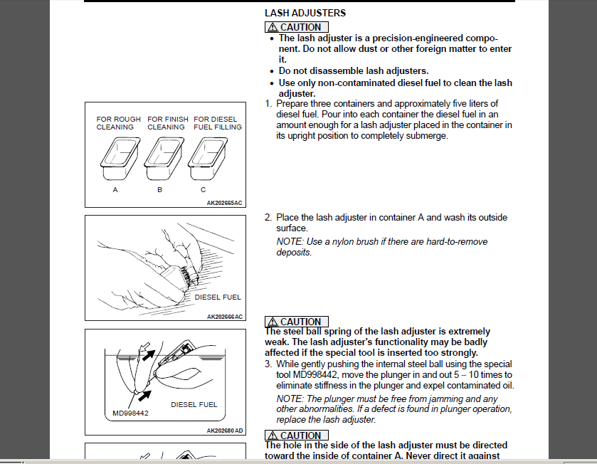

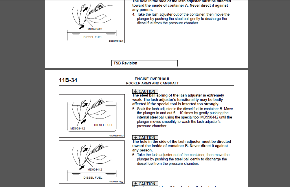

I thought it sounded crazy and have never heard of soaking them in diesel fuel or filling with diesel before installing but here is what the shop manual says

i just finished my head 10 minutes ago with springs/retainers and s2's and this ^^ was the method i used.
