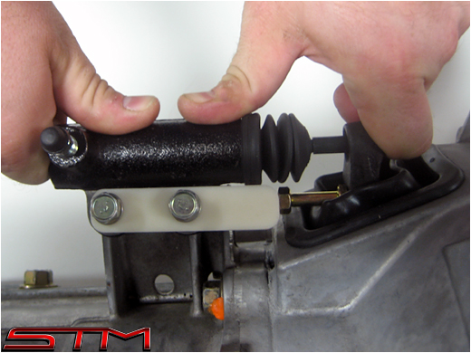

Thought my Exedy Twin Disk was shot after 10k miles, really bummed about it too. I checked my STM Clutch Fork Stop after not driving my car for a month and it had backed out so the fork had no movement ability. Took the fork stop out readjusted, wallah clutch holds torques again!

Old Sep 12, 2012 | 07:39 PM
j255c's Avatar
Joined: Jan 2007
Posts: 203
From: NY
It looks like this, its attached to the clutch slave. Mine was completely agains the fork there should be i think 1/8 space between the bolt and the fork.
It is an easy job, just remove the intake off the turbo, UICP and adjust accordingly.

Guy, just a quick question. Im about to in still my new clutch line and fork stopper.. my question is, what should the distance between the fork and the stopper be?
Thanks for any info and help you can give!!
Old Sep 22, 2012 | 08:24 AM
Spec-Ops1's Avatar
iTrader: (38)
Joined: Jun 2010
Posts: 1,229
From: Fayetteville,NC
1/8"
Just a heads up!
Same exact thing happen to me at 10k miles!
With someone in the drivers seat working the clutch, I can adjust it without removing it, it's a squeeze and my hands aren't small. I will probably cut a closed end side of the ?12mm wrench to give more room, but the open end works with a little patience.
