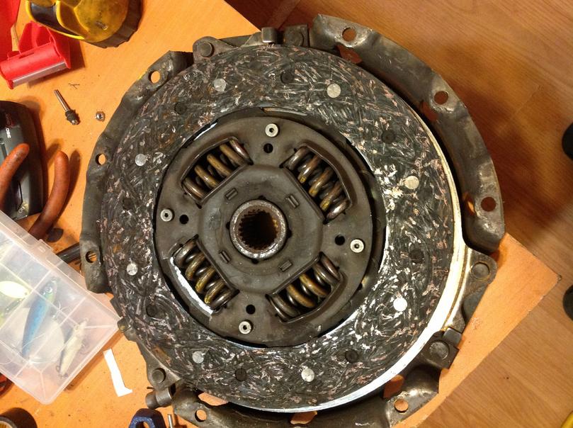

I am replacing my clutch on my Evo 8, the clutch that it came with was this Act clutch but I do not know what model it is. I would like to buy the same one. My evo has more or less 400whp.

I bet an act xtreme or heavy duty
call act they can help

Either an MB7-HDSS or MB7-XTSS. I can identify which by either a photo of the pressure plate or the numbers on the diaphragm spring. Depending on how old it is, the pressure plate part number may be engraved right on the cover (either MB017 or MB017X)

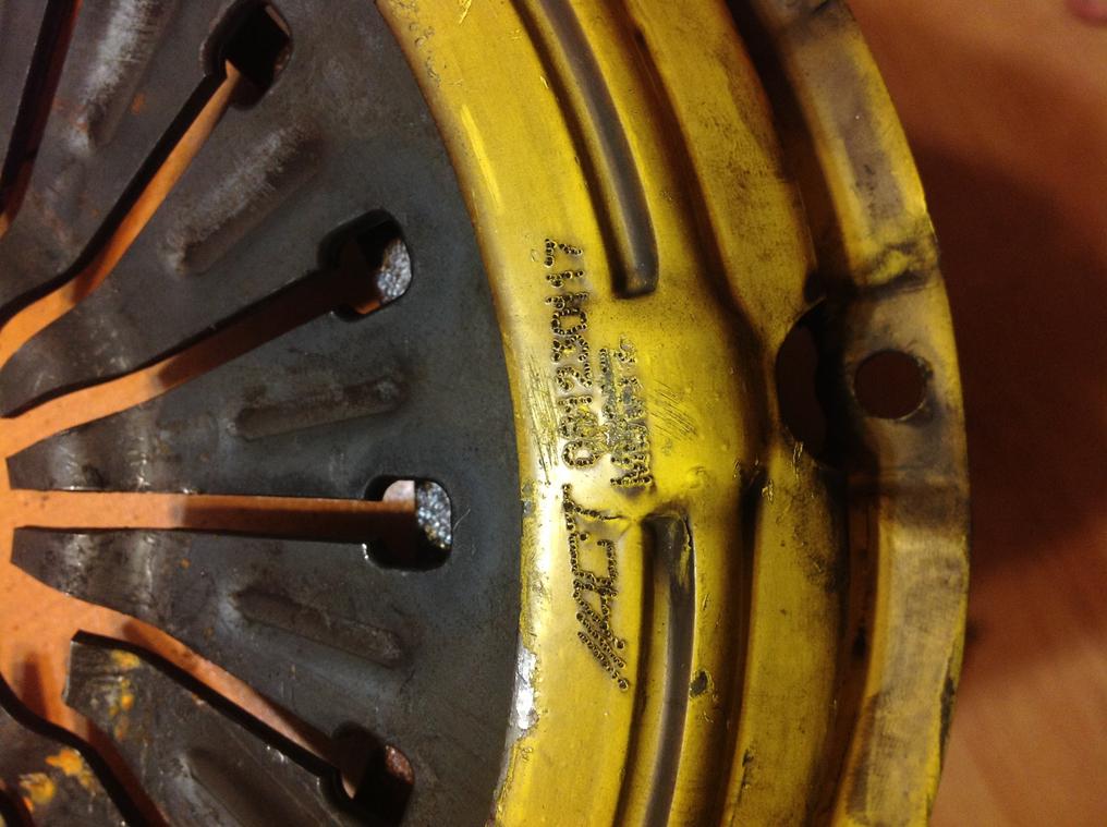

I believe it's an mb017

Yep. If you want the same clutch, order an MB7-HDSS kit.

Nope. If that were the case, the part number would be MB017X, but it isn't.
