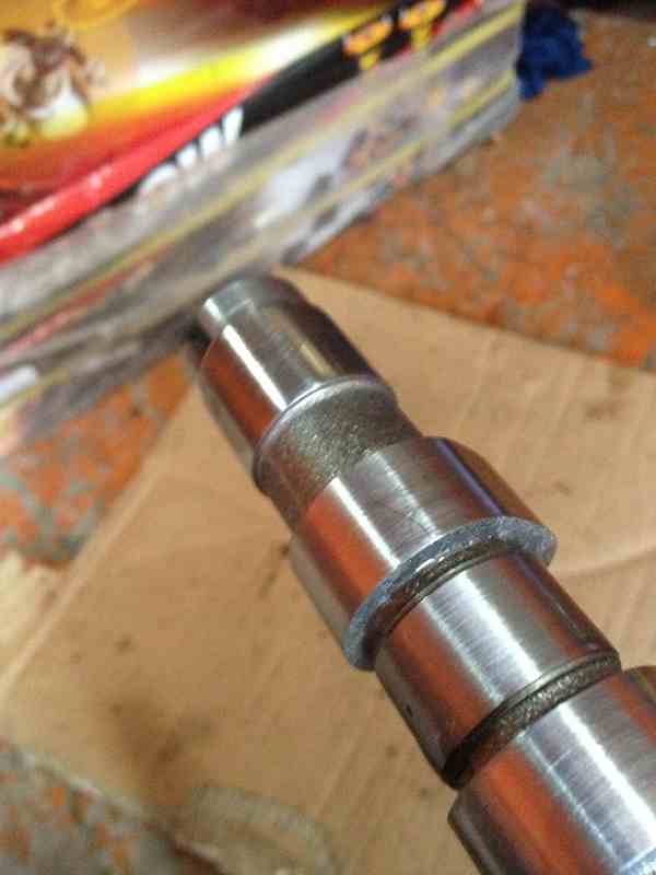

it is quality problem of the kelforld evo9 tx272 cams?there is somthing wrong with the cams.plesase have a see the photo that i attached.

that will cause low oil pressure.the cam bearing not wide enough.

It doesnt completely cover the oil feed in the last cam cap?
YES

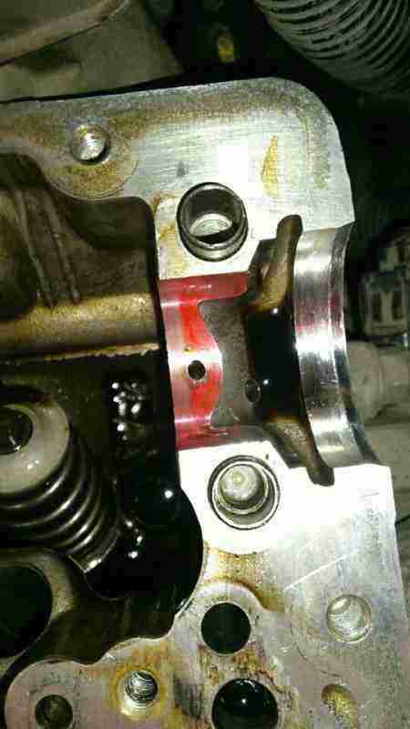

self machine work to fix the problem

I am very curious about more comments on this as I had the same scenario when installing the cams and figured it was by design somehow.
I have extremely low oil pressure at idle sometimes now and the valve train sounds like a diesel at times, clattering away.
I noticed the same fitment issue, but didn't evaluate it as not covering an oil output as needed.
I didn't completely follow what machining you did to solve the problem. Can provide some more details

yep,i dont know why kelford sell this cams in the aftermake.it is a big problem.
the 9-tx272 is crudely made,the stock is better.i dont know if other problem will appear when i use it.
first,you need to cut off that my finger pointed out .after that, make a bearing to install that position,the clearance should be like stock.that's all.

Originally Posted by newpassport
YES
Sorry confused by your answer. Yes it does cover the oil feed completely? Or No it does not cover the oil feed completely?
If it covers it completely its fine.
Aaron
sorry,my english is not good.

Does it make mechanical and logical sense that if this oil feed hole is not covered completely then in some cases, like low revs that the oil pump would not be providing enough oil pressure to the lifters?
Essentially I have this clattering when idle drops below 1k, and I have been trying to figure out could possibly causing it. If that opening is allowing oil to pump out without any resistance is that enough to cause the type of problem I am describing?
Gotta find my pics of my install......
you are right,low oil pressure
