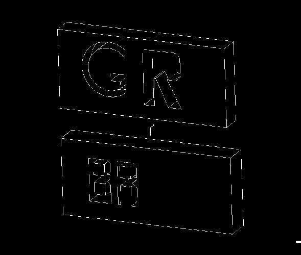

Originally posted by clappton
I think the Greddy FMIC looks small in that pic. The BR IC looks like it really fills every usable opening in the front.
Pictures are deceiving.... core size 600 x 276 x 76mm ( 23.62 x 10.886 x 2.99" thick)
Of course, the BR IC might be larger it's listed at 24 x 10.5 x 3.5".
Anyway, I don't know how it all works out in the end since the end tanks, and other design parameters would affect the actual volume of the IC. As far as which one looks larger, well.... the BR IC is 3/8" longer, but it's also 7/16" shorter in the height dimension....
Old Feb 12, 2004 | 08:06 AM
silverEVO8's Avatar
Posts: 2,659
From: Utopia
Here is a sketch of both ICs (core dimensions) done to scale. Greddy above, BR below

Heh, hard to really see any huge differences in that CAD image but I think the unique thing the BR FMIC kit brings to the table is definitely the piping
Well, if you multiply the core evelope dimensions, the BR is 882 cu. in. and the Greddy is 768.81 cu. in. All other things being equal (which we have no way of knowing at this time) the BR IC is 14.4% larger than the Greddy. Of course, this is just the area enveloped by the outside dimensions. The actual internal capacity depends on the area & length of the internal passages.
I'm not sure what you are talking about when you say piping. The BR does not come with piping, only the Greddy includes the piping (unless I missed something big time looking at the web sites) I think the upper IC pipes are a separate item at $330. The IC costs $750 so the total would be $1080 which is $100 less than the Greddy.....
