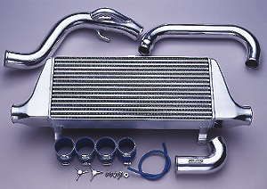

You might be right, but in my experience, the 180° tubes will flow infinitely better than any 90° abrupt, shap bend (by the way, the inlet pipe looks more like 120° than 180°). But anyway that might be academic because of other differences between the different IC's. I'm not sure what exactly the bar & plate is vs. the tube and fin. I see tubes and fins in every IC I've ever looked at so I'm prolly not sure of what the nomenclature really means. Here is a picture of the Greddy kit, maybe it can help to clarify matters somewhat.
Red letters are my edited correction, sorry for the confusion

What's the deal with that little loop on the intercooler pipe on the top left?
