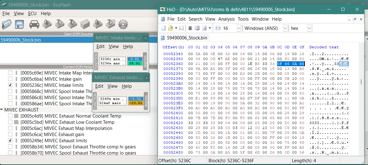

4B11 micec limits
4B11 mivec limits
In this pic you see the stock 4B11 cam rotation limits for a 25 degree rotation available with the 4B11 cam sprocket. +3 degree cam start timing with no sprocket rotation to +28 with maximum sprocket rotation.
A similar deal with the ex cam: -3 degree starting rotation to max 20 degree rotation of the ex sprocket to give a potential -23 degree cam timing.
In your ROM if you search for the 2 hex words that define the +3 and +28 values (0F 66 and 0A 66) you will find the address of the intake cam limits of rotation. Modifying these values to suit a 4B12 cam will mean that the start point is 0 degrees and the end point is 40 degrees. You must tell the truth for these settings otherwise the ecu will tell you lies about what is going on - a case of **** in - **** out.
Drop these lines into your def and change the address to where you find the values in your ROM.
<scaling name="MIVEC timing 2" units="degrees" toexpr="(4096- x)*0.01953" frexpr="4096-(x/0.01953)" format="%.2f" min="-80" max="80" inc="0.019" storagetype="uint16" endian="big"/>
<table name="MIVEC Intake limits" category="MIVEC INTAKE" address="5236c" type="2D" scaling="MIVEC timing 2">
<table name="FUNCTION" type="Static Y Axis" elements="2">
<data>5236c min .</data>
<data>5236e max .</data>
</table>
</table>
<table name="MIVEC Exhaust limits" category="MIVEC EXHAUST" address="5249e" type="2D" scaling="MIVEC timing 2">
<data>5249e min .</data>
<data>524a0 max .</data>
</table>
</table>

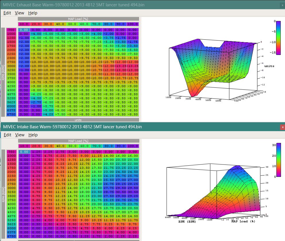

Then the hard bit..... the stock 4B11 mivec maps bear no resemblance to a tuned state. Forget what you see in these maps - they are hideous and cannot be unseen. Do not use stock mivec maps as a starting point to build tuned maps!
Start with as close as you can get to these (these maps are higher accuracy than stock)
