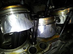

That is how the piston skirts (intake side) looked like after 6000km.

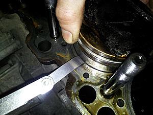

That is a 0.15mm feeler gauge. The piston easily slips in the cylinder.

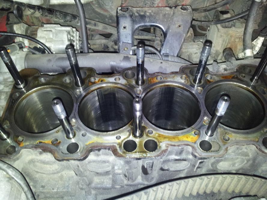

That is how cylinder walls looked like:
The shop that made all the honing and boring service was told to make 0.7mm PTW clearance as this is a stock turbo daily-driver that never see any serious abuse.
