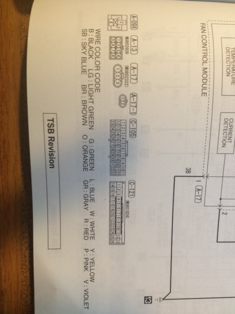

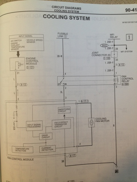

You need to go through the cooling system circuit with a multimeter and check various points.. A hot ground may be from too much resistance somewhere in the coolant systems' circuit.
Here's some schematics to help you out
Attached Thumbnails Need Help Please! Code P0117! Won't Start!-img_6712.jpg   Need Help Please! Code P0117! Won't Start!-img_4043.jpeg
Thanks for schematics BEkevo. I will try this, once I figure out how to do it. Not much experience with the multimeter, but I do have one.

The cooling fan coming on probably means the ECU thinks the engine is hot. A short or water in the wiring could do this.
Grounds should never get hot. No wires should get hot. If the car has had an engine swap maybe all the grounds didn't get reconnected. This also can screw up readings from under the hood.
Get the ECU scanned to see what the the ECU thinks the coolant temperature is. Explore and clean the engine grounds. It sounds like you may need the services of a good shop.
