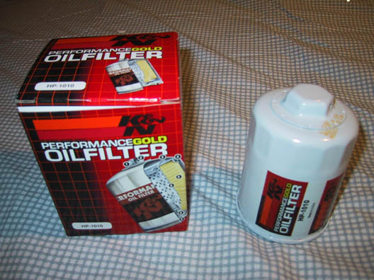

How about K&N oil filters? Some said that they are physically
smaller than OEM's...

As far as K&N filters... how much do they go for?
Btw.. here are some comparison pics of MZ vs MD that someone
post... their direct link was bad so I put the pics on my image
server...
More pics:
http://www.pbase.com/jt_kgy/evo_oil_filters
server...
More pics:
Been using both the Mobil M1-104 and the K&N HP-1004 for around 8000 miles and some road racing as well. Both have been holding up fine. Bought the K&N oil filter at Kragen for $9.99

The M1-108 was $11.99 at AutoZone. The 7317 was $1.97 at Walmart, but is sized more like the M1-110 (which was also priced $11.99 at AZ).
The M1-108 looks like the pictures referenced in your link. The 110 and SuperTech are a bit longer, but the same diameter. (They were out of M1-104s)
