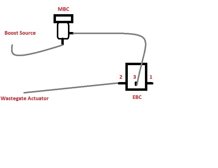

found one post on here about it, but seems to vague. i'm looking for a definite answer. does anyone have a diagram or can explain the configuration for a 3 port grimmspeed and hallman pro hybrid setup? thanks guys

From: U.S of A
Compliments of evilempire76
so i plug off port 1 and j pipe nipple?

jpipe nipple to mbc, mbc to port 3, port 2 to wastegate, leave port 1 open.

Can someone explain more about the benefit of this? ive been reading hearing more and more about it lately.

The idea is: spool/tq hit of the MBC, with top end boost holding capabilityof the EBC.
