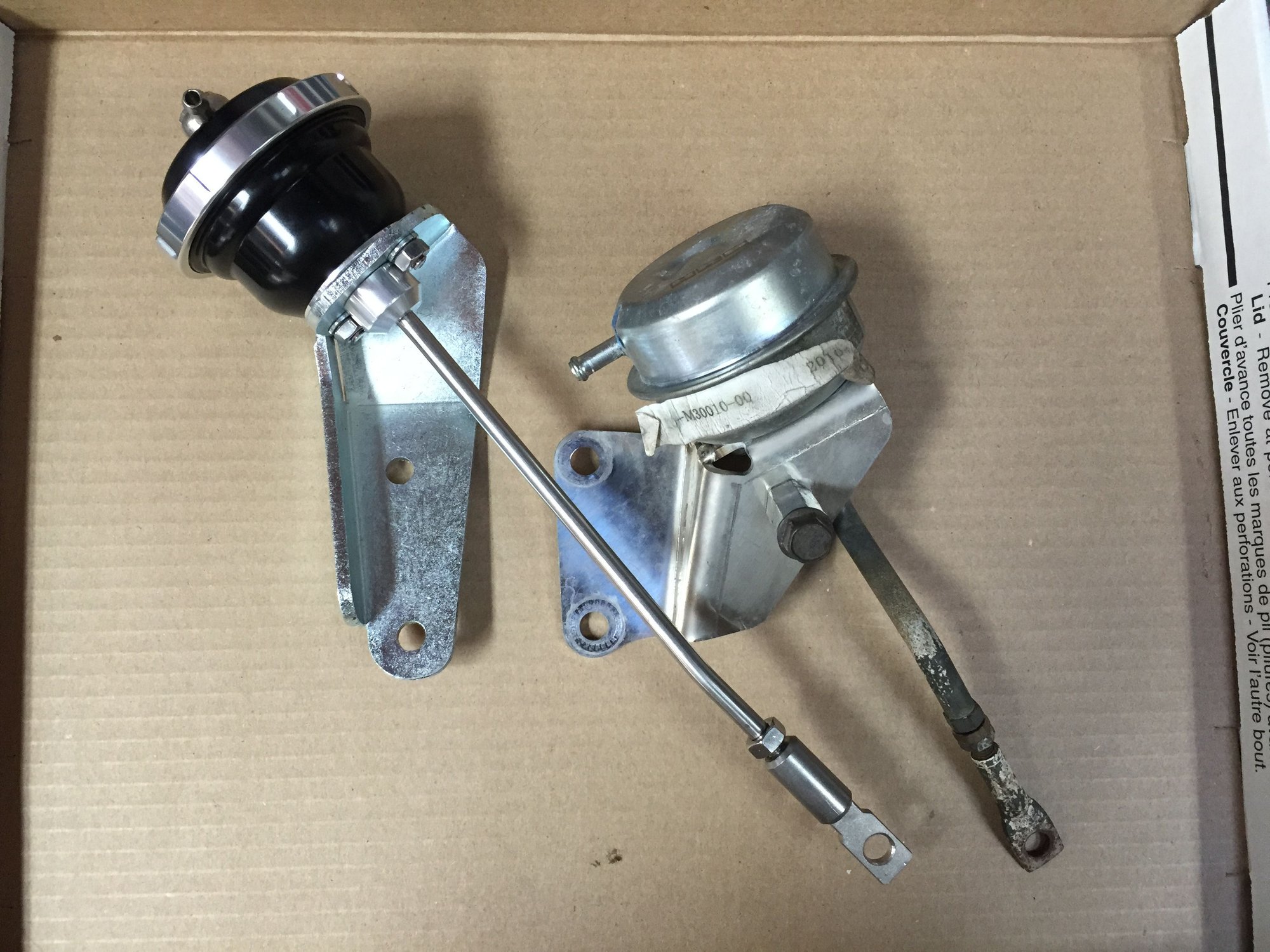

Old Oct 1, 2013 | 09:16 PM
EVONOT's Avatar
Joined: Mar 2010
Posts: 105
From: Ft Campbell, KY/TN
Oh btw sorry for being a little late..... but there is no BS so try someone else.
Lemme know if you have questions since u have it right in front of you.
Btw nothing custom was done, and I did it with everything intact.
and heres the old one:
HKS BROKEN ROD.
SO I HOPE THIS CLEARS THE AIR FOR ALL THE PEOPLE THAT RUN THIS TURBO and the KNOW IT ALL TECHS!!!!

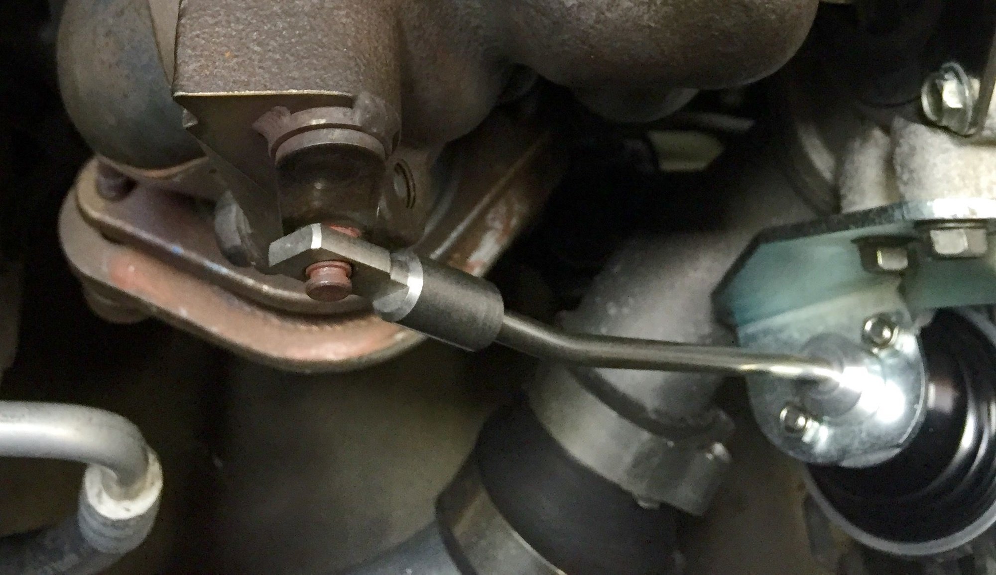

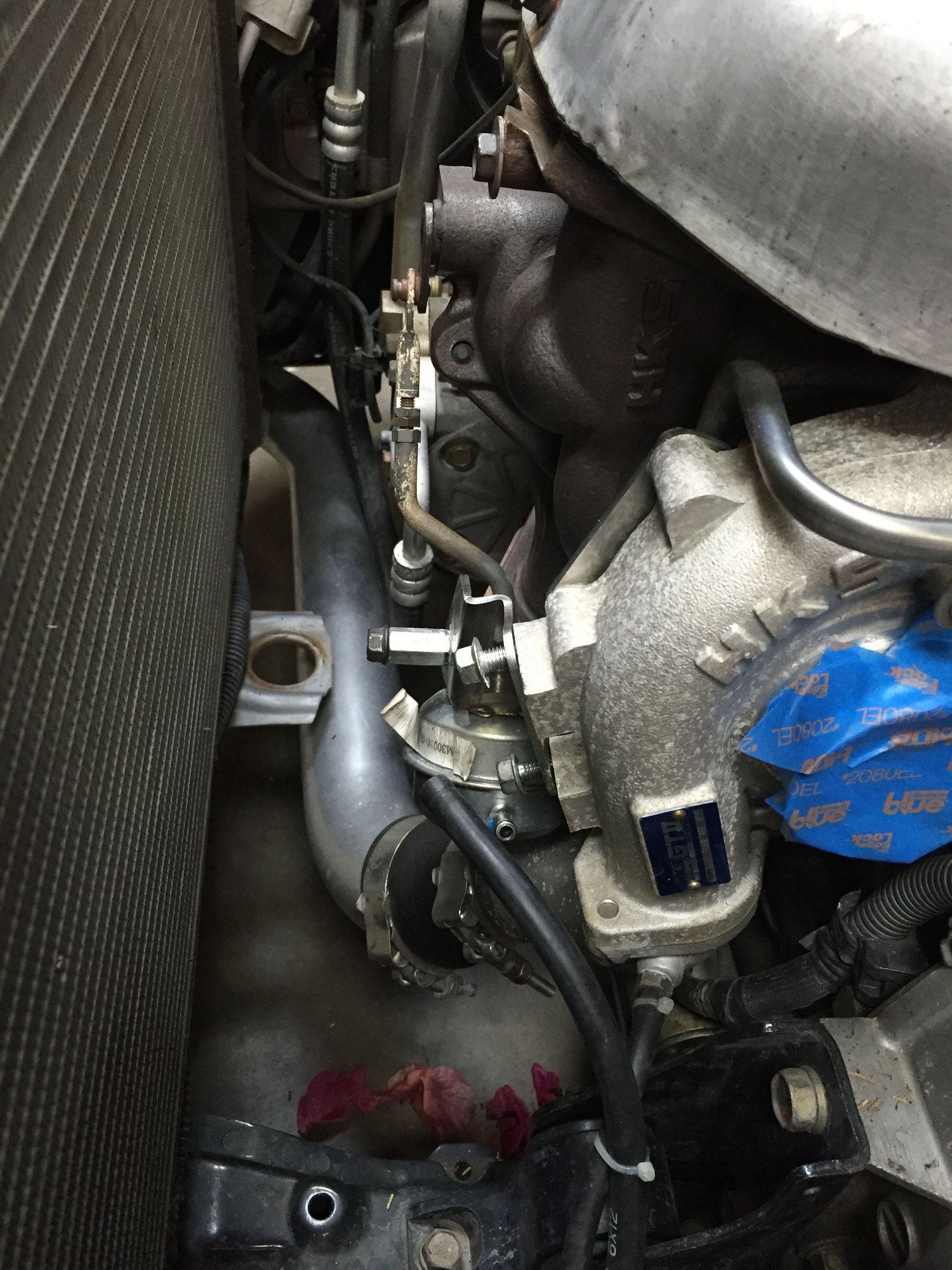

Thanks to EVONOT I tried this replacement path for my GT7460 as well. I went with the Turbosmart actuator and it too fits fine.
My concern is that I'd been loosing all my low end boost suggesting the wastegate was stuck open. Twice I had to tighten the stock actuator, ultimately cranking in all the threaded adjustment. Can anyone look at the image below and verify if the wastegate actuator arm appears bent, like it's twisting off inside?
Not sure if the angle of the wastegate flapper arm is supposed to be clocked like this. I'm concerned that my arm is twisting off inside...
Turbosmart Evo9 vs. HKS 7460 actuator.
Stock HKS 7460 actuator installed.
Turbosmart actuator installed on HKS GT 7460.
