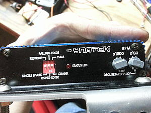

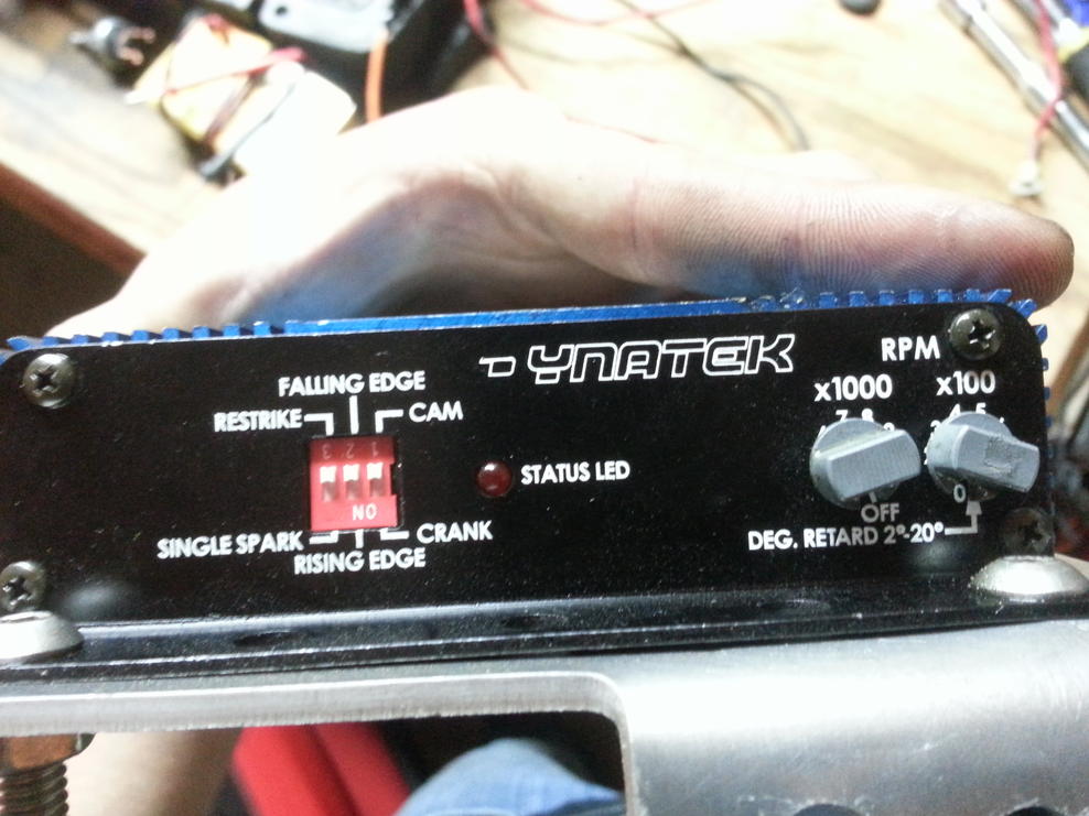

On another note I may have a lead on the issue, I have a Dynatek CDI in the car and it did not come with setup instructions. There for I did not adjust the "dip switches". The car ran fine so I figured all was well. After digging around I finally found some setup instructions for the Evo. Dynatek recommends that the switches be set to:
Falling Edge
Restrike or Single Spark
Crank Input
Mine was set at:
Falling Edge
Restrike
Cam Input
A couple of thoughts, being set to restrike maybe it is causing the cylinder to ignite more than once? Second how would it effect the way the CDI operates with it being set to Cam Input instead of the Crank Input.

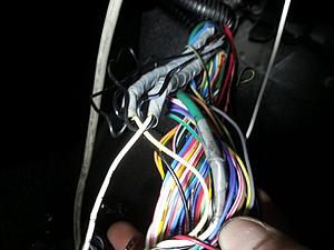

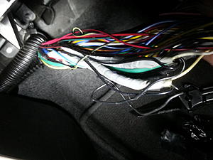

Beings I only have one Evo and nothing to compare it too could someone let me know if this is how the Evo comes from Mitsubishi? This is at the wiring harness to the ECU, I am checking everything due to this failure and it just doesn't seem right that Mitsubishi would wire something like this but I can't be sure. Here are the pictures,
Pin 75 is white then connects to a larger blue wire under the gray electrical tape, this is listed to be O2 Sensor Rear.
Pin 78 is a short white wire that connects to a larger green wire under the gray tape, this is listed as Knock Sensor.
Pin 87 is white and connects to a larger black wire under the gray electrical tape, this one is listed as Avail.
Pin 92 "ground" is spliced in a couple of locations, the wire from the connector goes into the harness and connects to three other small black wires under some black electrical tape, then there are a couple of looped wires that connect to Pin 75 and Pin 87.
My evo 8 is the same

I think you might have solved it. Cam and Crank are not usually synched the same time. Might be wrong but it's not normally the case so if the cam timing signal is before the crank and the map was assuming it was crank KABANG. Multiple spark will not cause that problem. If the car missed the first time it might generate more heat in the exhaust or burn the exhaust valves but they fire so fast I don't see a problem there.

It makes since that the input setting on the CDI could have caused this problem however I would think it would make the car run like crap and it just doesn't make since that two different tuners wouldn't pick up that something was not responding properly. But to this date I have not found anything else that appears to have been installed or not functioning properly. I will continue the search!
