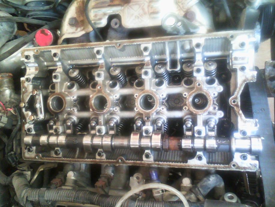

Update*
Installed the JUN 264 cams after cleaning and bleeding the HLAs which were hard as a rock. The cams are currently set as 0 intake / 0 exhaust .
The idle was loopy but the response of the car above 2000 rpm changed radically, the response was amazing. I could literally feel the air rushing through.. Spool , mid range and top end was improved significantly over the stock cams.
Using stock springs and retainers car is at 1 bar boost. Changed some values in the fuel and timing map but the idle is jittery even after pushing the idle upto 1200 rpm. As soon as i turn on the A/C the idle becomes much more stable but without a/c its loopy.
I tried adding fuel at the idle rpm and load cells but the ecu still hunts for 14.7 and hovers around 14.7 to 16. There is a table named OPEN LOOP TPS vs RPM which helps in idle stability but sadly i cant any such table in my rom. the rom is 93660005.
Need your help.
Thanks

Old Jun 29, 2014 | 10:12 AM
mines5's Avatar
Joined: Oct 2010
Posts: 870
Likes: 23
From: Streets of willow
Pics

Originally Posted by 94AWDcoupe
did you get your car to idle good? what kind of vacuum did you have at idle? and at what rpm? as I remember them they looped pretty good even on a 2.3 engine
Basically, i made a mistake, i didnt install adjustable cam gears with them, so i couldnt do much to adjust the overlap. If you drop them straight in, the idle is very loopy [ 280 like ] . I wasnt running a tephra rom, so didnt had the luxury of adjusting alot of parameters.
i dont exactly remember the vacuum i had but it wasnt stable at all. I tried to raise the idle to 1000, 1100 but the difference wasnt so obvious.
