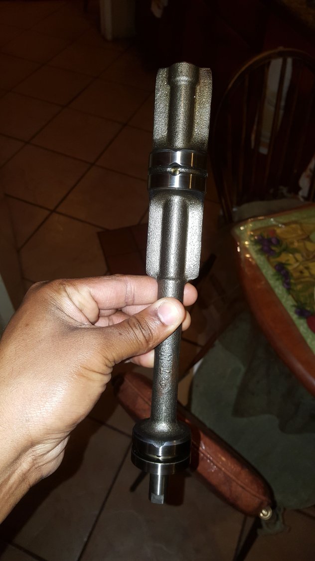

hand polish the bearing races with 800 grit wet paper. that one race looks like silver paint on it? is that a water stain? water stains are never really a problem. just lightly polish high spots off. dont try to make curb side appeal perfect. they just need to measure round. with no high or low spots.
bad balance shafts are when you see the heaviest part of shaft bearing starting to wear. thats when the bearing race is no longer round.
