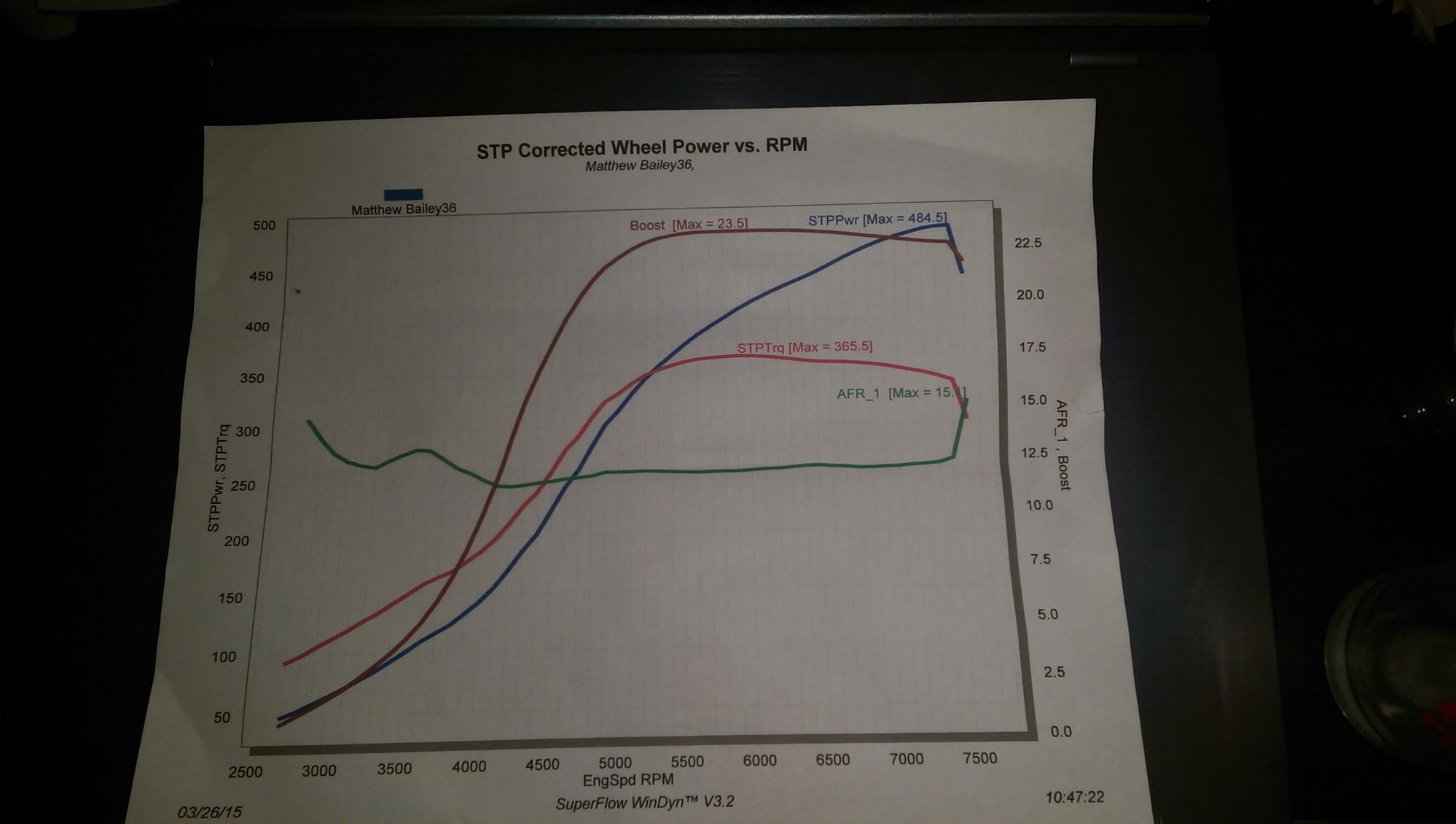

I'd like to see a dyno graph if you will post it up.
I'll try to post up a dyno sheet later tonight.

Yeah id like to see dyno run too.

Here's my E85 graph couldn't find my 91 pump graph. On 91 she made 410hp/338trq at 22.7 psi.
